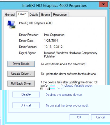

When I am using MS Visual FoxPro development environment on TSPlus 8.10.3.7 I often experience window flickering after a mouse click. The windows flash dozens of times and then stops. The server is Windows 2012 R2 and the video driver is an Intel Driver. I have attached a screen shot of the driver. I have seen this sometimes with the admin tool. In previous messages it was mentioned that it was due to basic Microsoft video drivers being install but this time it is an Intel driver.
I do not seem to have this problem on two other Windows 2012 R2 servers which use the same driver.
Simon
