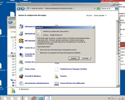

Hello
I try to unnistall Tsplus 9.6 with Java 32 bits then I update java to 64 bits try to install again tsplus and show me thta tspolus is installed, so I used the file Uninst.exe that you suggest and righ now show me: the image (,exe files can be run)

I am sorry to read that you went into such issue.
This strange and rare issue is related to the use of old version of TSplus (8.xx).
I am attaching a .reg file to be executed on your server to restore these lost file associations.
FixRegExtension.rar
(1.24 KiB) Downloaded 1110 times
In order to reinstall TSplus sucessfully on your server, please make sure these two folders do not remain, if so delete them :
C:\wsession
C:\Program files (x86)\TSplus
ratoque
