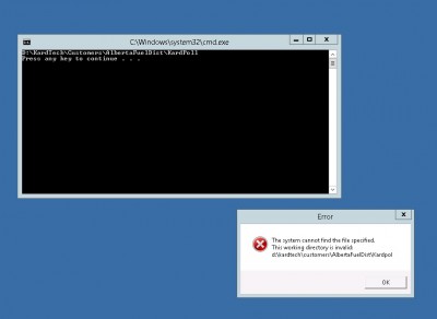

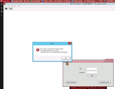

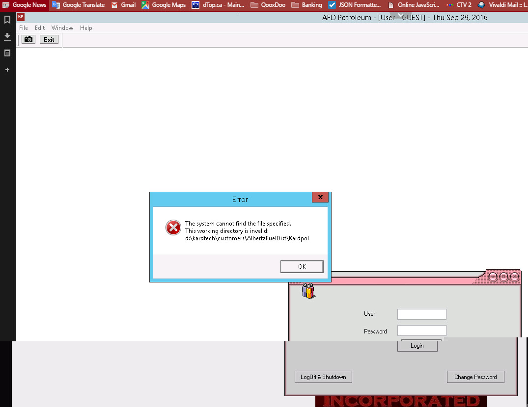

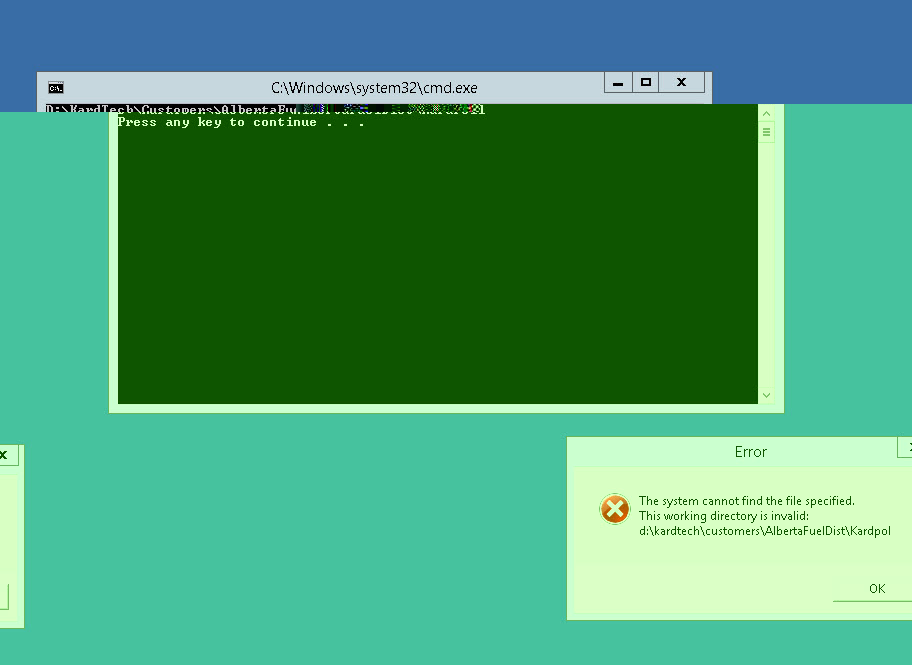

Since I upgraded to 9.50.9.22 I have web login user that reports "This working directory is invalid" but then runs the application anyway. The working directory is indeed correct and the application runs just fine. You can see the application running with the error message on the screen in TS_AlbertaFuels image.

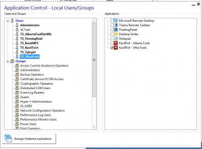

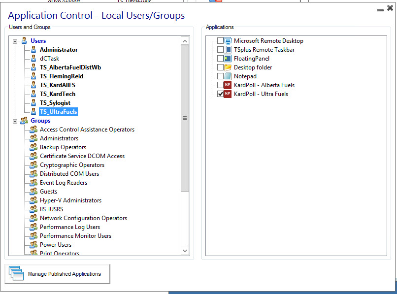

On the same server we have another web login user using the same application and they do not have the "This working directory is invalid" error message. Instead the application is launched twice. You can see in the attached image that they only have one application assigned but it is launched twice.

Hi
I created the batch file and changed the Published application to dcmain.bat and you can see that the error still occurs but the batch files runs. The interesting thing is that the error message displays first before the batch file displays anything.
Simon
Simon
Re: This Working Directory is Invalid
Okay, this is great, because then we know it's nothing to do with your app - and not even TSplus (I think).

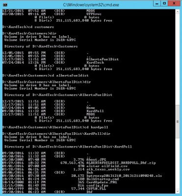

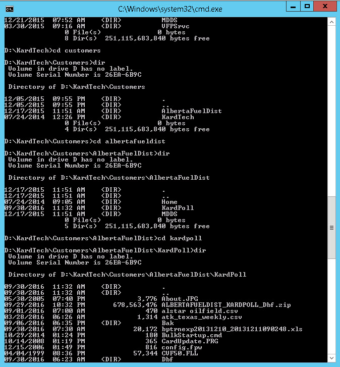

If you change your path to C:\Windows\System32\cmd.exe (directory C:\Windows\System32\) and start it as the user and then try the following to see where you get an error:
My first idea would be security settings of the directory, which doesn't allow the user to list the folder.
Code: Select all
CD /D D:\
DIR
CD KardTech
DIR
CD Customers
DIR
CD AlbertaFuelDist
DIR
CD KardPoll
DIR
REM Lastly you can try to run the dcmain.bat
dcmain.batRe: This Working Directory is Invalid
Everything works just fine including the batch file.
