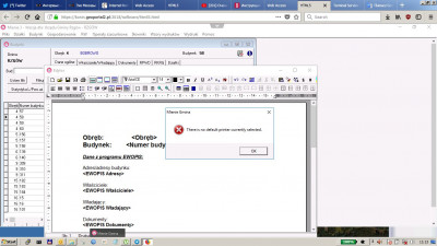

I have two TSP servers with LB configured.
When the user logs on the first (gateway) server, he can print without problems.
When Load Balancer redirect the user to the second server there is a problem with printing (no default printer currently selected). Look attachment.
Universal printer (Ghostscript) installed and set as default on both servers.
Universal printer issue with Load Balancing

None of this helped. We only had to recompile our applications with the latest version Delphi.

Re: Universal printer issue with Load Balancing [SOVED]
Yes.
I confirm that only our dedicated applications in Delphi can't print.
All other App print without issue.
I can give your admin access to our servers, but old application not availible for me, now is rewrit, recompile and now print without issue.
This is my my sugestion to our developers:
"Actually it is a Delphi(5) problem. The comparison of the available printers and the default printer is case sensitive (Printers.pas):
if TPrinterDevice(Objects).Device = Device then
begin
with TPrinterDevice(Objects) do
SetPrinter(PChar(Device), PChar(Driver), PChar(Port), 0);
Exit;
end;
Changing the comparison to: if lowercase(TPrinterDevice(Objects).Device) = lowercase(Device) solves the problem."
