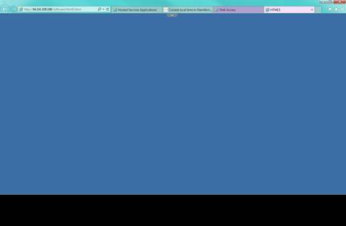

As I mentioned previously we are having a problem with clients logging to a TSPLus server using a web browser. Some times all they see is the blue screen as shown in the image attached. At other times they see an alternating black screen followed by the screen showing the connection is being secured as shown in the second image attached.
When the browser was alternating between the black screen and the securing your connection screen. I restarted the web server using the Admin Tool and the browser displayed the connection broken warning, then it displayed the connection established and then the application logged in properly. However, just a few minutes later I retried the web browser access and experience the same problem.
I updated the Server to TSPLus 8.3.8.3 but the problems persists. This server worked fine for the past year until Oct 7th, 2015 when we started having these problems and the customers are getting very frustrated.
I need a solution to fix this problem before we lose the customer entirely.

Have you seen this same issue on google chrome? My users see the issue and I have to have them click in the address bar and press enter to 'refresh' the screen and then it comes back on. Just curious if that works for you as a temp workaround. I am on an older 8.10.2.12 version..

Yes I have seen this in Google Chrome.

Open an admin tool, and click on "Web Management Tool". make sure all features are set to green. if not, click on "Restart Web Server". If the server won't start, make sure you have not installed another web server or application that would be using the TCP port 80 and/or 443 (Skype and Teamviewer for example). One easy test to do is to change the port of your webserver and restart the server again. A faq regarding this subject is available here : tsplus.net/support/kb/faq.php?id=6
Make also sure that your firewalls and / or antivirus (software or hardware) are not blocking port 80 and/or port 443 or any TSplus processes located in these two folders :
C:\Program Files (x86)\TSplus
C:\wsession
Open a browser on the server, type in the address 127.0.0.2 and open a connection using the java or html5 mode. You should be able to open a session with a local or domain account.
If it still wont connect, uninstall java and delete the java folder located in C:\Program Files x86\ then reinstall java 64 bits on the server and make sure antivirus or firewall software are not blocking HTML5service.exe and SSHtunnel.exe processes.

I uninstalled TSPlus completely and then reinstalled everything and the problem seems to have disappeared. It is strange that this same server worked for 1 year without problems and then started having issues on Oct 7th when the only change to the server was a Windows update. Now that everything has been re-installed it seems to work fine again.
Simon
