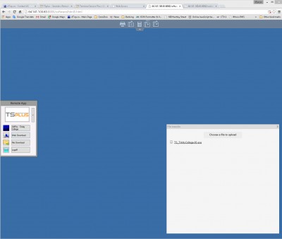

Hi
I have setup an new Windows 2012 Server with the TSPlus 8.3 and when I try to do a web-download I get the error shown in the attached image. Basically it says it cannot find the file that I just selected in the web downloader.
How do I fix this issue?
Simon
Simon

does it happen only on specific files? Is file not accidently hidden? (in such case webserver does not see it even when explorer does)
Well, the path is ok, so no evident cause visible.. May be giving guest access to your system would make me finding this bug faster, actually only on picture it is hard to reproduce it or guess what exactly causes it.

Hi
All I did was put the file in the user's download folder. The server name is dw15. The strange part is that Windows File Explorer shows the path as C:\Users\TS_TrinityCollege\Downloads\TS_TrinityCollege-00.exe. So the path I showed in the web downloader from the web browser is different than the true path.
This problem also happens with .txt files. I created a new document and put it in the downloads folder and had the same problem when trying to download it using the web browser.
This exact same process works fine in version 8.20.4.11. It does not work in version 8.3.6.24
Simon
Simon

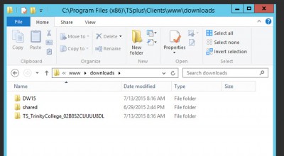

Re: Web download - File not found.
Hi
When the client first logs into the server two folders are created in c:\TSPlus\Clients\www\downloads as shown in the attached image. You can see that a folder called DW15 and one called TrinityCollege.... are created. If I delete them and login again the folders are again created. Therefore the DW15 reference in the download has something to do with TSPlus.
I should also mention that the server is using IIS8 or IIS7.
Simon
Simon
