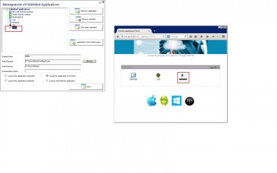

Persian or arabic language not sopported in web application portal ???
the problem is shown below:
arabic/Persian lang not sopported in web application portal?
- Attachments
- 1.jpg (15.4 KiB) Viewed 14472 times

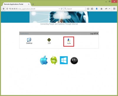

This image has better quality:
Re: arabic/Persian lang not sopported in web application por
Could you open the file "C:\Program Files (x86)\TSplus\UserDesktop\files\AppControl.ini" with Notepad++ and tell us what encoding is used?
To find the encoding, in Notepad++ click on the "Encoding" menu - one of the items should be selected.
Changing encoding to UTF-16LE then saving the file could fix the issue.

smsmoosavi
- Posts: 11
- Joined: Mon Feb 02, 2015 5:12 pm
Thanks
After opening Appcontrol.ini with Notepad++, I select "UTF-8" from Encoding Menu then save it.
It is done and worked fine.
thank you Adrien.
thanks TSplus Team for reply.
thank you Adrien.
