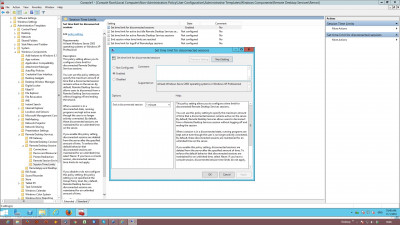

As explained in my first message, I have already tried your given suggestion i.e. enabled this group policy through MMC.EXE Snap-In for Non Administrator users. But it does not work. Kindly check my settings in enclosed snap shot.
If I set this policy through TSPLUS console (Group Policies). It gets implemented successfully for all the users including Administrator. I feel that the settings of GPO of TSPLUS are being override to the GPO policies of MMC in this case.
Rest all policies works well for Non Administrator users set through MMC Snap-in like "Hiding Drives" etc.
