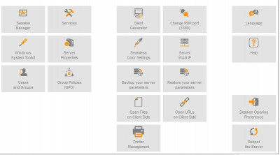

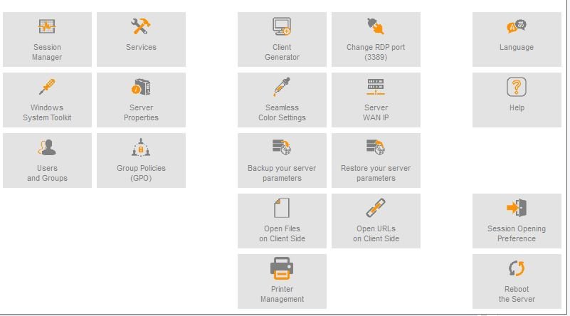

Hi admin, first, many thanks for your answer and support
. I want you to know that we followed your instrucctions "...Open an admin tool, server tile, click on "Desktop Taskbar", make sure to uncheck the "Hide systray icons..." but the "Desktop Taskbar" doesn´t appear in our server menu, see the picture attached.
How we can activate or see the "Desktop Taskbar" button/option in our Server Menu screen?
BUT, the good news is, we rename the file ltaskbar.exe into xltaskbar.exe and works perfect!!
Many thanks again, you are the best!!

Sorry I meant "Remote Taskbar" option... Glad to know this solved your issue.
