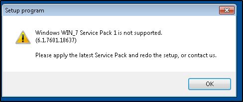

The patch does not work for my installation, even after removing kbs, applying patch,
I have even uninstalled and reinstalled the new downloaded, :repaired" installation.
NOT working.
New install even pops up a message about incompability (mind you, i have applied the compability patch).
The operating system is Windows 7 SP1 64bit, oem licensed.
All windows update patches are installed but the 2 kb this forum reccomended removing.
I have oppened a support ticket 6 hours ago - beside telling me to use the compatibility patch, i have no response from the support team.
Can anyone here help please?

UPDATE: Re: Connection Issues of the 11/14
The only solution taht worked here was using system restore to restore the registry to a former state and disabeling windows update.
