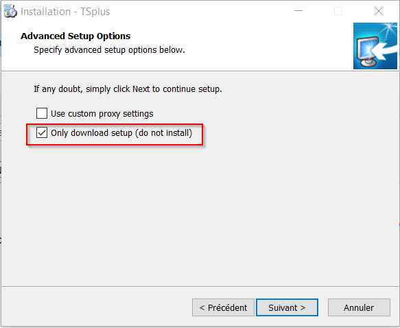

This seem to indicate that your server cannot access the download file. This can occur because of a firewall or antivirus. You can always download the update from this permalink here and check the "only download setup" from a computer that has access to internet, copy it or transfer it to your server and execute it : https://secure-download-file.com/data/S ... curity.exe
