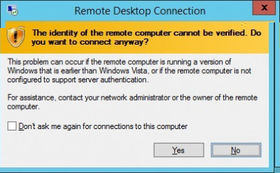

Hi.
I have a Flexi Cloud test farm, all servers Windows 2012 R1 are domain joined, updated with latest Windows updates.
After upgrading to latest Flexi Cloud v 10.40.7.30, when the administrator try to connect via RDP to the servers, he is presented with a message box advising that "The identity of the remote computer cannot be verified ... This problem occur if the remote computer is running a version of Windows that is earlier than Windows Vista, or if the remote computer is not configured to support server authentication".
[img] [/img].
Besides of this, tsplus users seems login correctly as usually.
What is happened ?

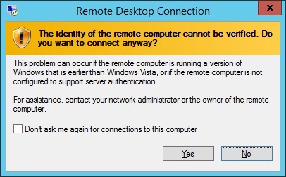

[img] [/img].
What is happened ?
Re: TSPLUS 10.40.7.30 upgrade break Windows Server 2012 authentication
This pop up is normal and should have no influence on your connection. Simply click connect.
If your server got updated to Windows 2016, then most likely you inherited the new RDP 10 protocol. As always, Microsoft does not keep a good descending compatibility with lower versions of Windows.
I never seen this popup before, no Windows 2016 around, the client computer where I connect from and the Flexi Cloud servers where I connect to are all Windows 2012 R2 Standard members of same domain and all are updated with the latest Windows Update patches, so the unique software change happened in meantime is the upgrade to Flexi Cloud v 10.40.7.30 from 10.40.7.7.
I tried to follow your instructions to change the encryption level via GPO followed by a gpupdate /force, but without luck.
There are no RDP update for Windows 2012 R2.
It is very strange that before the prompt was not appearing :/
Maybe the Flexi Cloud upgrade change some RDP settings ?
"Don't ask me again for connections to this computer"
Just check this check box and you will not see this usual annoying Windows pop-up.
It is easy and there is no problem to do so.
Just one more comment: To establish its connection, TSplus is generated a standard .rdp file named session.rdpand this .rdp file is store in ../RDP6 folder in the user PC current profile.
Then it is the standard user mstsc.exe which is started by the TSplus client.
Nothing in this process is specific to TSplus and everything belong to standard Windows behavior.
So, it cannot be a release of TSplus which can change such standard Window behavior.
Strange enough, also after checking the "Don't ask me again for connections to this computer", Windows was keeping to ask credentials, ignoring these previously saved.
I have had to go to the Control Panel > User Accounts > Manage your credentials and remove the saved credentials of the Tsplus servers, restarting mstsc.exe and checking the "Allow me to save the credentials".
After having done this, I was able to connect successfully to my Tsplus servers using saved credentials.
I noticed that the credentials for Tsplus servers was now saved under the "Generic credentials" not "Windows credentials".
Hi Carlo.
Good catch!
I was also facing this issue of having to enter credentials every time I connected to the servers using RDP. Deleted the credential, created again and it works now. Also noticed it got moved to the Generic Credentials afterwards.
